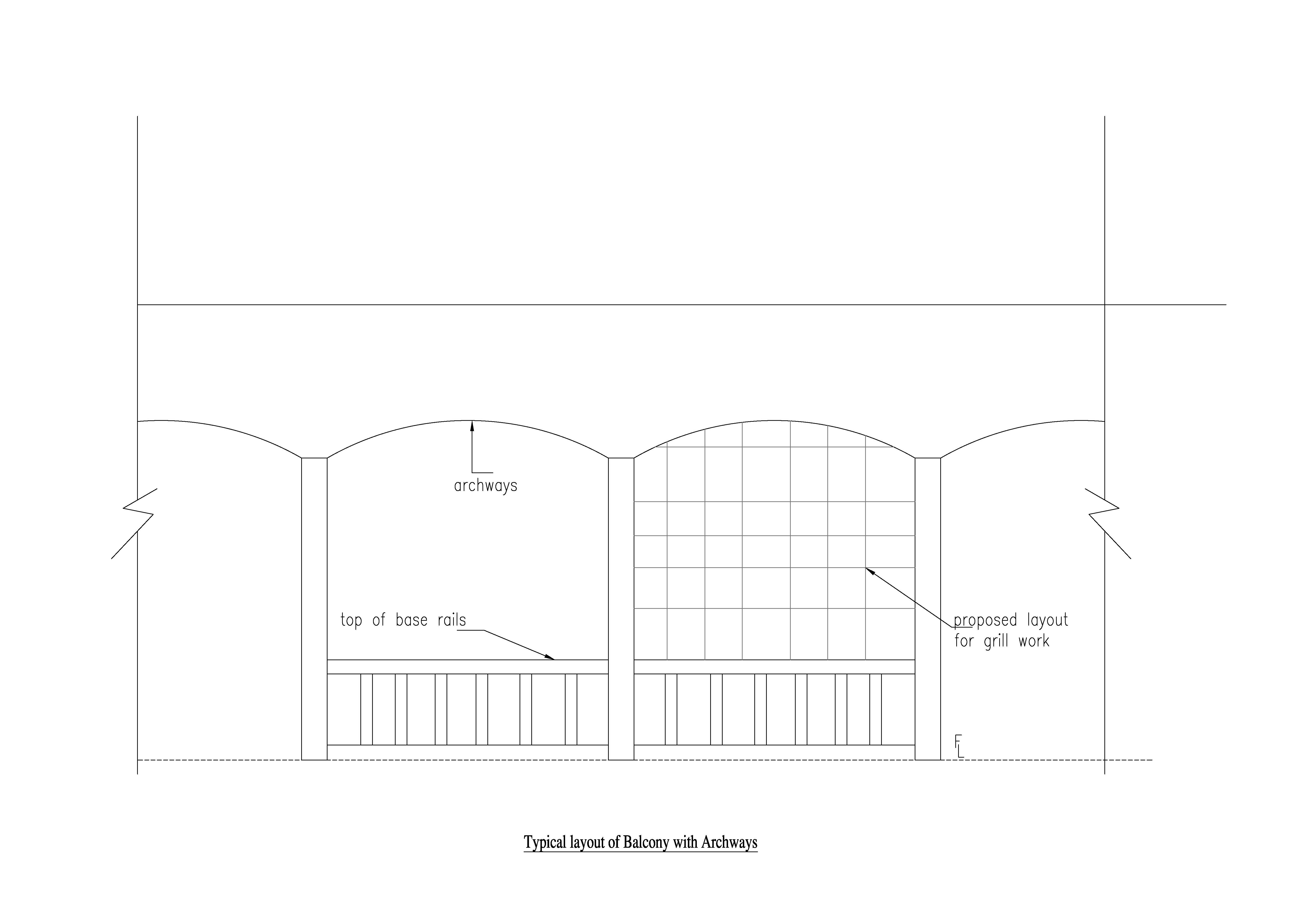

Hi I'M trying to place grillwork for arches beyween columns on a porch.How do i model this.I was able to do it with railings
by placing a floor on top of the lower walls on a straight surface.I'm struggling to get the railings to follow the the curve of the archway
archway above.Any help will be greatly appreciated.Please see attached file.

Please see attached file.Sorry, The last  attachment exceeded the file limit so it did not go through.Thanks for responding
i'm looking forward to solving this issue.

You could do it as a seperate window family that would cut the wall exactly how you wanted it, or could use a generic model and model to your requirements and place in your opening or you could try using a curtain wall for this also.  What does the grillwork look like?  I see your drawing but is there something in a real life application you are going off of that we could look at to maybe better answer you?
