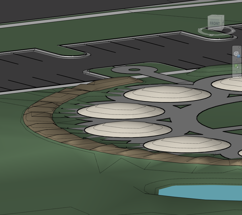

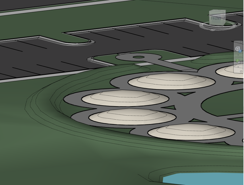

I have a similar problem.  When I have the topo by itself everything looks fine.  When I add a subregion it looks jagged and incorrect.  Oh revit how I love/hate you...
Mon, Nov 24, 2014 at 4:12:40 PM | Subregion changes topo's elevation?
#9
palladio1234
Joined: Wed, Jan 6, 2010
99 Posts
5 Stars: 3 Votes
After I posted this naturally I figured it out.  When you place a subregion on a custom made topography like I did it makes the topo surface more specific with calculating the surface between points.  I had to add more detailed points for the topography to look properly.  Not sure why subregions cause this, but this is how I fixed my problem.
