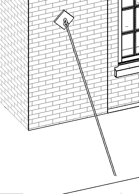

how would i show cables that are holding up a ramp. the cables would be hanging off a building and connected to a ramp . what is the easiest way of showing this does anyone know?
Mon, May 7, 2012 at 9:22:55 AM | showing cables
I made a simple family for a project that I was just working on.  I create a workplan in the project at the angle that will host this element.  Then in plan, I set this work plane and place this family.  Then I adjust the length.
