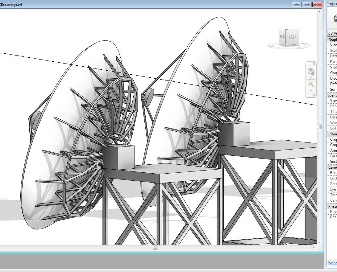

Radial array is your friend.   Here are some sloppy sattelite dishes we have gracing a property next to ours... just modeled one truss, and arrayed it 20 times around the dish.  Looks pretty convincing, and in the end took about 5 minutes.

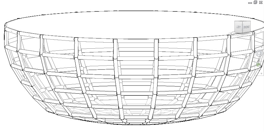

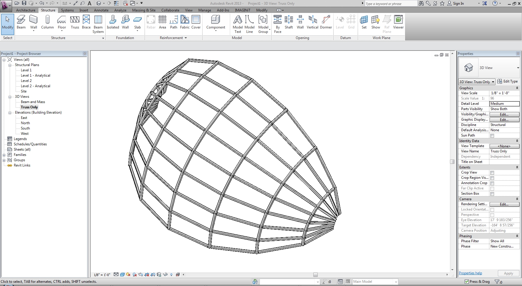

Create a mass and divide its surface. Then, in a 3d view with the mass visible, use the beam tool with the pick line option. Square beams have a tendancy to twist in strange ways, but pipe beams would look great with no modification. See the attached files.
105944_Autodesk_Revit_2013_-_3D_View_Truss_Only_-_Project12012-05-0312-47-16.jpg105944_Autodesk_Revit_2013_-_3D_View_Beam_and_Mass_-_Project12012-05-0312-47-28.jpg
