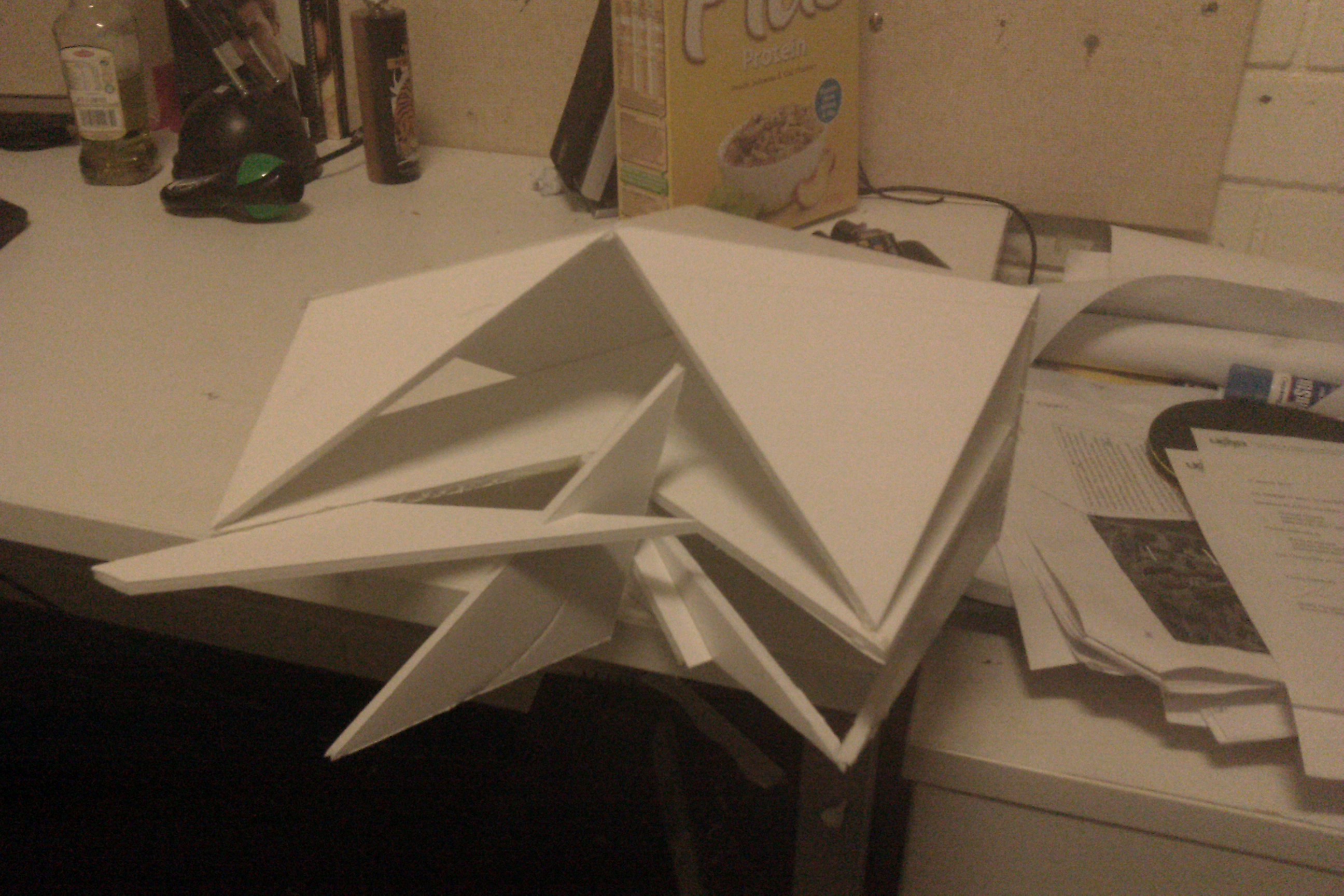

Hi I have been learning revit for 2 months now and have come up with a design concept, now I am having trouble with
creating the roof for my design. I will upload a photo of a rough model I made of it.
But basically the roof starts at ground levein some areas.
cheers, would be great help if someone could give me a hand

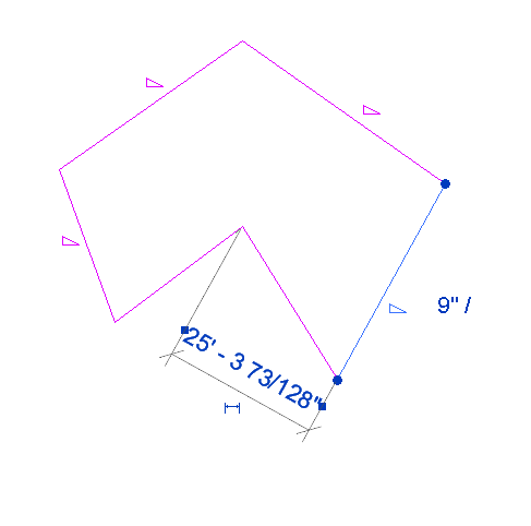

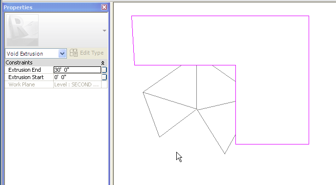

Mon, Apr 30, 2012 at 12:24:17 PM | Abstract roof
This is by no means your roof but maybe it will help you understand.

Quoting bla0005 from 2012-04-30 09:54:26
The only problem with using the footprint line is that if i were to draw a triangle in plan and click the tick it will create a
roof within that space. Also when u say use vertical void do you mean using the cut geometry tool?
He means making a model-in-place family in the roof category, which is a void extrusion, which you then use cut geometry with, yes.
what you'd do is create a squished triangle in plan, (the outline you see when looking at your model from top down,) give it a slope, and keep upping the slope until it matches what you've got on your mock-up.
