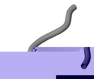

 A noodle shape? Something like the attached?  It was created using a sweep.
