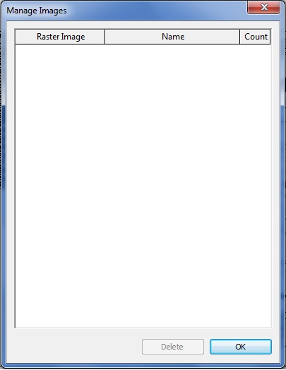

I was wondering if anybody knows of a way to select all "imported CAD" files for review to be deleted or kept, maybe similar to the way you can manage Raster images in the project. (see attached)
We have a few cad imports sitting somewhere in the project that are taking up room in the already large file size.  However with 80+ views to sift through, it can be quite time consuming to find them and delete them.
I'm not expecting that revit has this feature, but if there is a simpler way to do this, I'd appreciate knowing.
