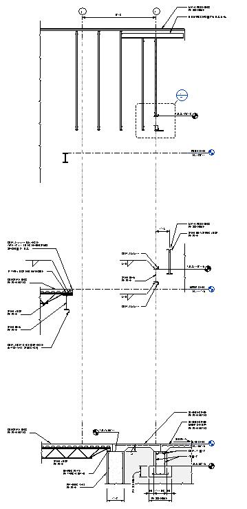

I have a section cut in my Revit Structure model.
I want to insert a CAD file of the architect's matching section.
After inserting it, I can't see it.
It IS there.  I CAN select it (by luckily picking it out of thin air) and it will show up as a blue tinted, selected object.  But, as soon as I unselect it, it dissapears.  I've had this problem a lot before, and usually if I zoom out a good bit, the linked file will be visible.  But when I zoom in tight, it dissappears.  However, in this case, it doesn't show at all no matter the zoom level.
The good news is that it DOES show in print preview, and it DOES print.
But it's really difficult to work with it, if I can't see it in Revit. Sad
Any help would be HUGELY appreciated.

Here's a couple of screen shots:
  • one with Linked CAD file "invisible"
  • one with Linked CAD file SELECTED & thus, "visible"
Any clues?

Well, I was hoping to upload a Revit Model and the AutoCAD detail, but for the life of me, I can't get the revit model below the 2mb file size limit.  I've deleted nearly the entire model, purged it, and even used Ideat Explorer to find hidden things to delete.  I'm going crazy!
Anyway, the CAD file is a WBLOCKED view of only the needed section, and its in model space.
Graphics Card is Nvidia Quadro 2000.  Revit Options says that the driver I'm using is NEWER than the certified driver.  I tried turning off graphics acceleration but it didn't help. (see attached)
