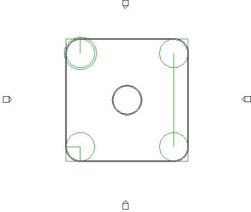

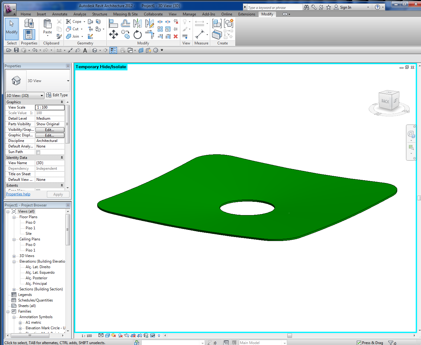

Something like this?

Something like this? -------> CONCEPTUAL MASS
Mon, Apr 9, 2012 at 1:39:38 PM | Dome roof?
Joined: Tue, May 22, 2007
5921 Posts
4 Stars: 205 Votes
Or MODEL IN-PLACE

Yeah, thats pretty much exactly what I want.

I created mine using the MODEL IN-PLACE approach and creating a sweep.  It would be a preference as to how you want to do it as far as conceptual mass vs model in-place.
