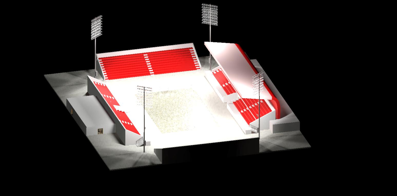

CHAsports, the family actually works, but the main problem was the light source definition in the nested family. I changed it to Circle with IES photometrics and assigned it the spot ideal ies file that comes with Revit. Then I changed the lumen output to 20,000 (it was set at 1800, which won't do much to dispel the darkness). I also got rid of the glass bulb as it is a classic case of over-modeling, and moved the light source a little further forward in the fixture head. I did a quickie rendering showing that it does cast light in renderings, but I suggest you find a more appropriate ies file from the lamp or fixture manufacturer as the lumen value may still be too low. See attached rendering. Edited family also attached. HTH.

The photometric file determines the distribution of the light, not the lumen output of the Revit light object. The Initial Intensity value is still set at 1800 lumens, which is about the light output of a 120W halogen Par 38 flood lamp. This value tells Revit how much light to give out from the light object. A bunch of 120w par lamps just won't light a stadium. Google the exact lamp type you are planning to use in this fixture and find out what its lumen output is, and put that number into the Initial Intensity field. Also see if you can find the manufacturer's photometric file. Where did you find that ies file? It doesn't have the kind of shape I would expect to see for stadium floodlights.
