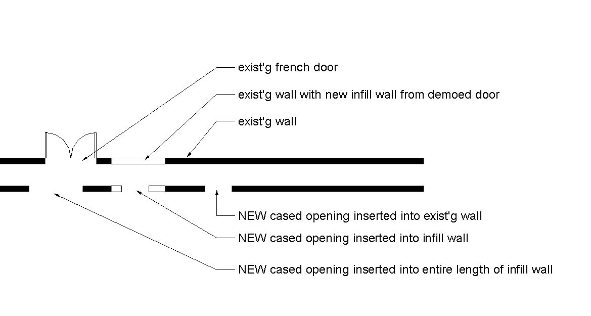

I thought I was getting it.  You have an existing french door which (in "reality"-I am not speaking Revit here), you want to eliminate.  But, you don;t want to close the wall off, you just want to remove the leafs, hinges, patch the jamb (or replace) so it is a cased opening.  In Revit speak, you are demoing the EXISTING french doors in the NEW CONSTRUCTION phase, and making it a cased opening in the NEW CONSTRUCTION phase.  As such, you need to add a cased opening the same width as the old door.  See the attached image.....I don;t THINK I am losing my mind here, but crazy people don;t know they are going crazy, so I may be in trouble
EDIT:  Please let me know if I am going crazy, or this is what you were looking for.  Thanks.

OK Liz, you're not going crazy!, you got it in RL
Its just IN REVIT you cant get from double doors to plain cased opening, because the demo tool adds the wall bit. then the new door cuts that new wall out...in revit. just a new cased opening, and a note saying "remove (E) Doors, leave opening" is enough. :-)
ps. THANKS FOR THE DRAWING! even if it was quick, I appreciate the time you took to do that.

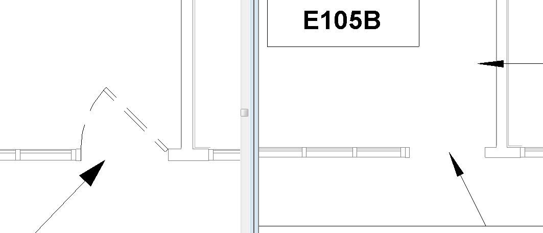

This is an odd work around but it seems to be working for me graphically...
Create a cased opening in existing to the proper width, then place your door in the exact same place. Set the doors to created existing, demo in demo phase. Make your cased opening created existing, no demo.
Attached you see the demo drawing on the left and the new const on the right.
