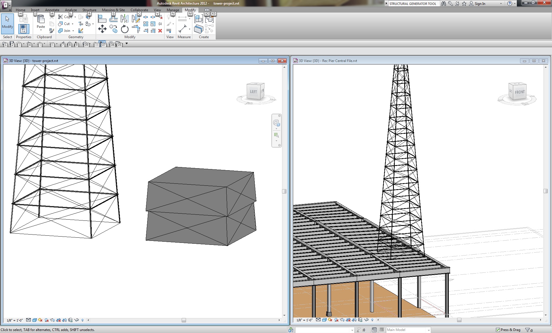

I’m trying to make a tapered mass where I can stack them on top of each other and the bottom of one would take the size of the one its sitting on. I remember seeing a tutorial years ago, but I can’t seem to remember how to do it
I’m making a pretty tall light tower with cross bracing and i thought this would be the quickest way. Any help would be greatly appreciated

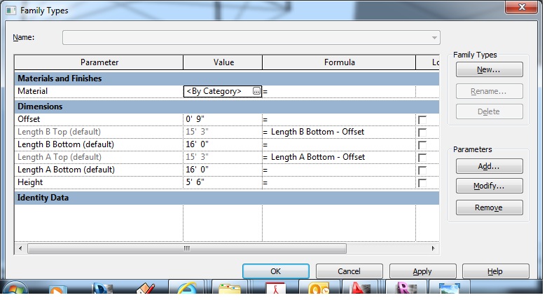

i wasnt going to use columns since the original wasnt built using columns..  it looks like it was built using all steel angles and angle cross bracing. Attached is what i came up with but i wasnt able to get my family to automatically adjust to the size of the mas below it.  i attached an image of the parameters. if anyone knows how i can fix it so i dont have to manually adjust it, that would be awesome. i attached the family as well in case some can figure it out

i just to make a parametric family that will taper according to the mass below it.  i want to use it to make sweeps not actual steel columns because im replicating an actual existing tower which is using all steel angles.
but i dont know the exact size of this tower so if it changes, id like to be able to make a quick change using this family
i know its possible, i saw it years ago and i cant remeber how to do it or where i saw the tutorial

jsel13,  I am still not convinced you are approaching this the right way, but of course I don't know all the details of your project.  In the interest of learning, If I had to do what you are talking about, I would create a family with a whole lot of parameters, Such as:
Mass1 Bottom Width
Mass1 Bottom Depth
Mass1 Top Width
Mass1 Top Depth
Mass1 Bottom Height
Mass 1 Top Height
That would create the first mass.
Then you make a second mass and make similar parameters, but some would have a formula attached:
Mass2 Bottom Width = Mass1 Top Width
Mass2 Bottom Depth = Mass1 Top Depth
Etc.
The question is how many boxes are you going to build, and it could get to be a very long and cumbersome creation.

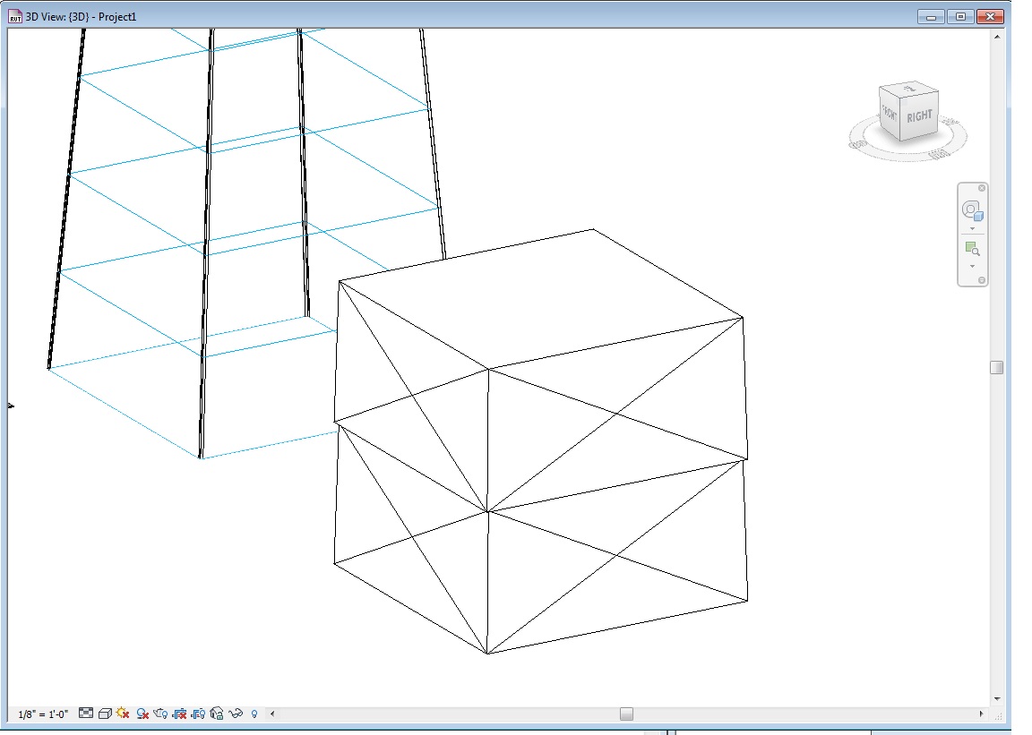

there are 18 of them
i saw a tutorial once where someone built a tapered box, then arrayed it up so the boxes sat on top of each other and they conformed to the one below it. it was like 2 to 3 years ago and i cant find it online anywhere. i saved it when i saw it, but i switched jobs recently and i must not of copied it.
 i think it was a mass family which was brought into a project, then it was arrayed and rotated, but the bottom of one equaled the top of the other and there were like 30 of them in the example im talking about

i think they were just creating a mass for a building showing how you can align the bottom of one mass family with the top of the one below it and rotate it up to creat a building that was tapered and rotated
kind of like what im trying to do here without the rotating
i know there are easier ways to do what im trying to do here specifically. but as teafoe said, it would good to know how to do this.
