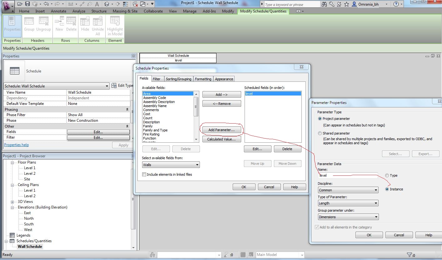

Hi, i m facing problems in Wall Schedule & quantities. In Revit i use to prepare the Quantities & Schedules for wall. In that case i m getting the schedule for entire model and all floors. But I want to the quantities for Each Floor. For that i want to add the Level Parameter. so for i m not succeeded. In Revit if u take the Door Schedules, there u will get the Level Parameter. But in wall i m not able to get the same. Can anybody help how to include the Level parameter in Wall Quantity & schedules

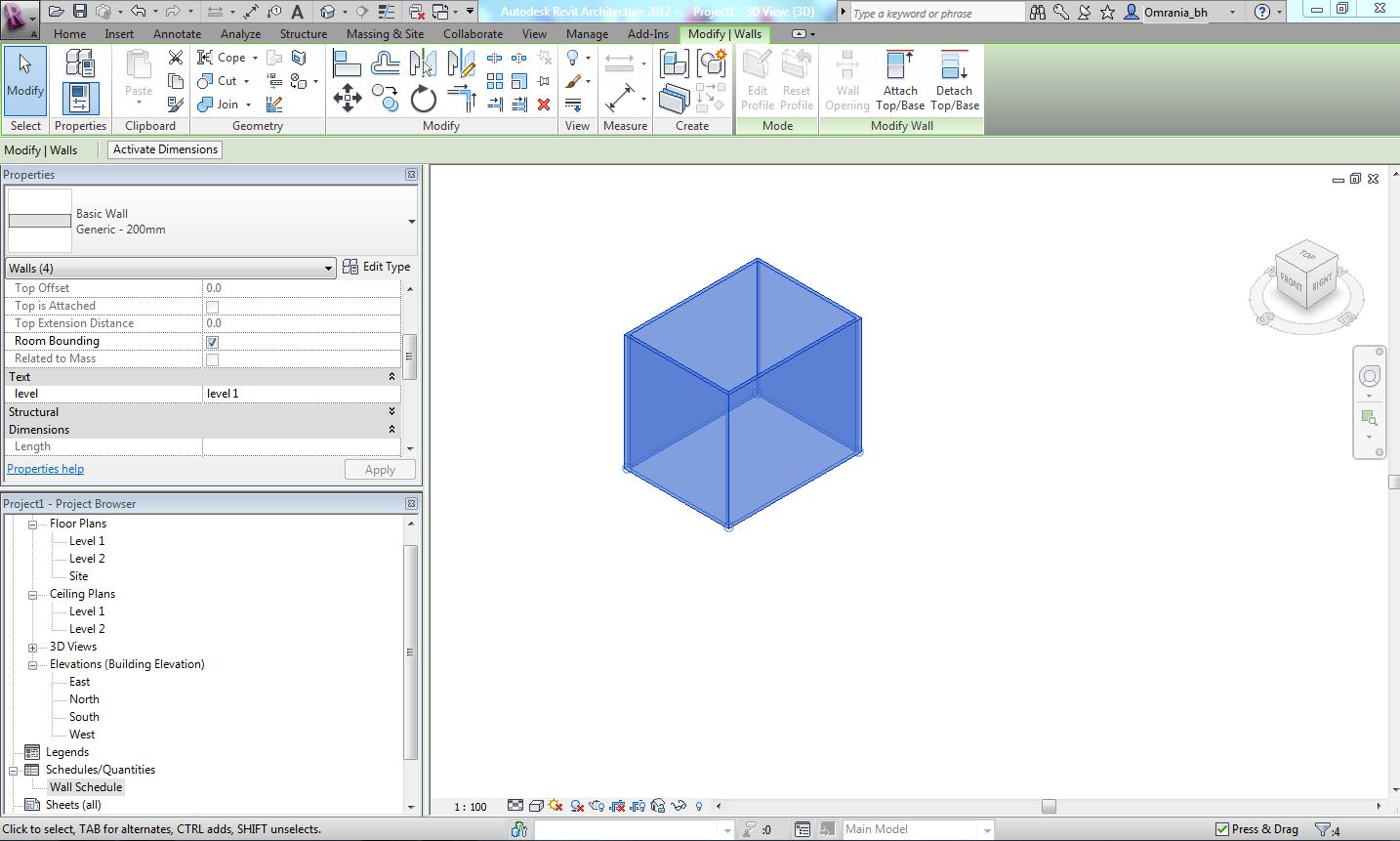

I don't have parametric solution ,the solution i have is to split the walls to it self to be every level,but you have to creat new parameter called levels and select the walls of each floor and define the level of each floor int he wall type
