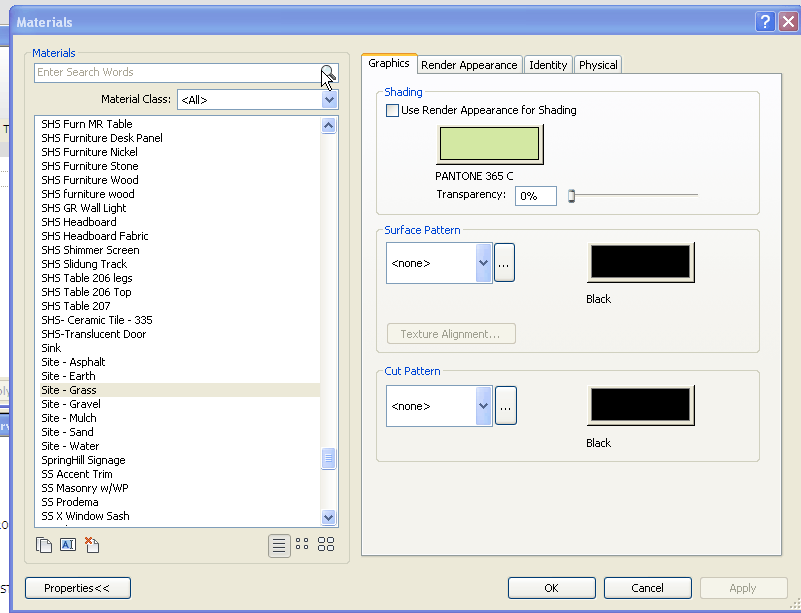

I have 2 toposurfaces that I need different surface colors.
They are already different on screen but how do I change it?
http://content.screencast.com/users/zuzullo/folders/Jing/media/337a165b-0621-4949-8719-6a43833560a2/2012-03-15_1417.png
Do you wanna SKYPE Revit? Its quicker Smile
Thu, Mar 15, 2012 at 8:53:46 AM | TOPOSURFACE - change color
It is not a surface pattern.  Just the material for shading - see attached.
And you do have to assign that material to that topography under properties.

Well at first it was grey and you set it to red so now it is red.  You have to fish the material edit before it will change.  And as I said, that material has to be assigned to that surface (and there can't be any over-rides).

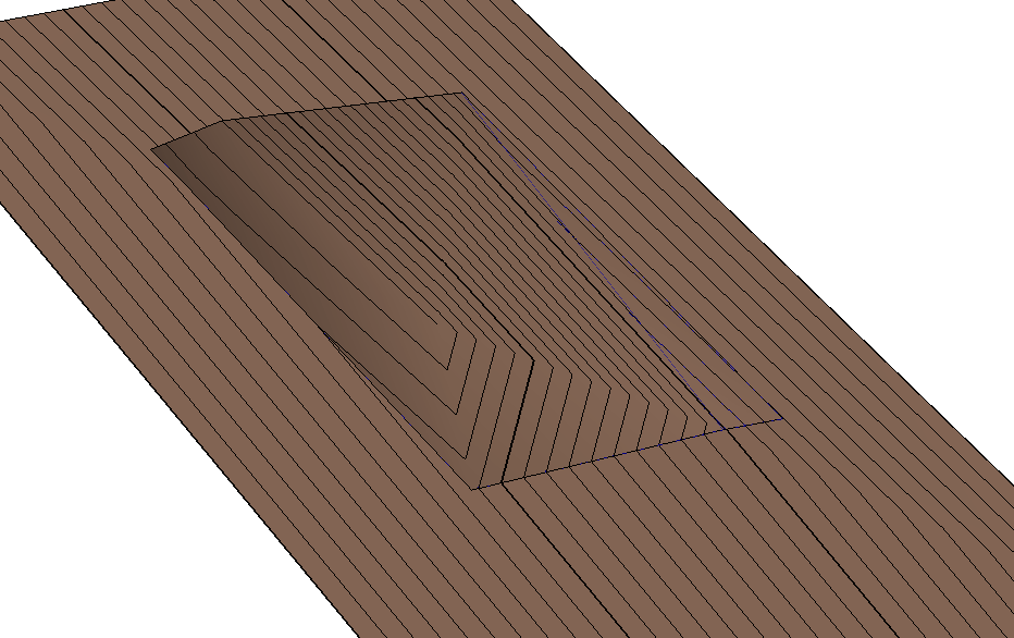

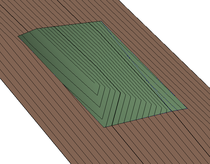

Fri, Mar 16, 2012 at 7:38:47 AM | TOPOSURFACE - change color
The Red color is not standard.  We have not modified any settings for this on our system so when I split off an area and regrade it, it stays the same color as the base.  (SEE ATTACHED) Then I change the properties of that region to grass - see attached.
You have this set somewhere else in your system.  Might be phase?  I don't know where it has been changed but it is not standard and that is why you can't seem to change its color.
Wish I could help more.

Yes, you right, I have changed the phase setting. Does that mean that we cannot change the color then?
