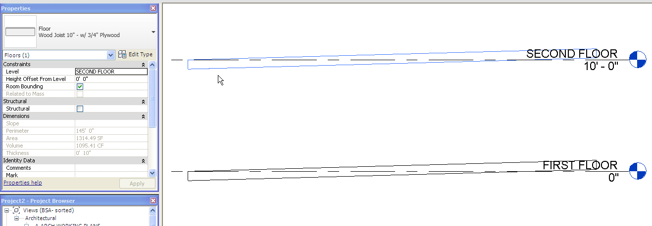

Sorry but I am having a hard time following what you are doing.
If all of your floors have the same slope and the same relationship to their levels, then just copy the floor and paste aligned to selected levels and you are done.

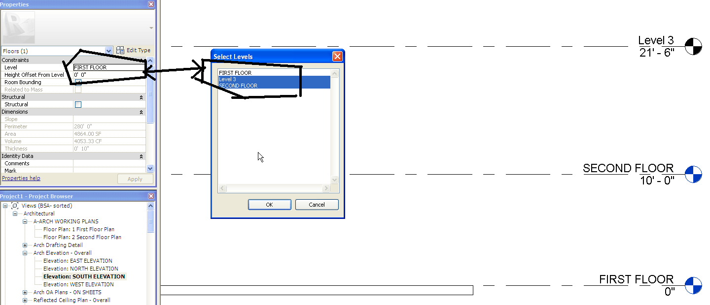

You are not doing what I said to do.  Copy the floor to clipboard and paste to selected levels.  I've not been doing this all these years for nothing....
In your HELP read this topic:  Pasting Aligned Elements
  1. Cut or copy elements to the clipboard.
    See Moving Elements with Cut-and-Paste or Copying Elements to the Clipboard.
  2. Click Modify tab Clipboard panel Paste drop-down, and select one of the following options:
    • Aligned to Selected Levels: If you copy all model elements, you can paste them into one or more levels. In the dialog that displays, choose the levels by name. To select more than one, press Ctrl while selecting the names.
    • Aligned to Selected Views: If you copy view-specific elements (such as dimensions) or model and view-specific elements, you can paste them into similar types of views.
    • Aligned to Current View: Pastes the elements to the current view. For example, you can paste elements from a plan view to a callout view. The view must be different from the view where the elements were cut or copied.
    • Aligned to Same Place: Pastes the elements into the same place from where you cut or copied them. This is useful for pasting elements between worksets or design options. Also, you can use it to paste between 2 files that have shared coordinates.
    • Aligned to Picked Level: Pastes the elements in an elevation view. You must be in an elevation view to use this tool, because it requires that you select a level line on which to paste the elements.
    • NoteDo not pick levels using the Project Browser.

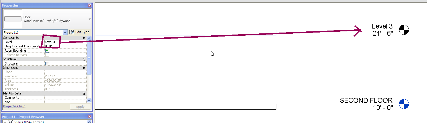

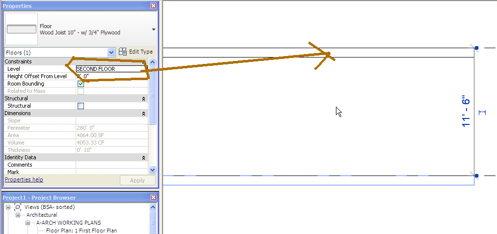

Wed, Mar 14, 2012 at 2:52:55 PM | Sloped floors relating to their level
No - when you paste to selected levels, it is pasted to that level!!!!
104224_ScreenHunter03_Mar._14_15.49.gif104224_ScreenHunter02_Mar._14_15.48.gif104224_ScreenHunter01_Mar._14_15.48.gif

Wed, Mar 14, 2012 at 3:18:49 PM | Sloped floors relating to their level
#9
My process still works even with a slope arrow.
