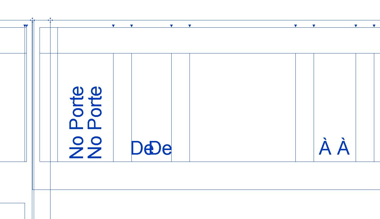

we created a schedule. placed it in the sheet but it apears to have two colums when we obviously only need one... cant reduce the number of columns with usual method (dragging) it seems to have many drag points that do nothing. it also apears to have multiple overlapping scedules in the same place.... tried duplicating the schedule.... no luck.
in the process of recreating the central, doing an audit, and recreating local files.. is this a known issue I have not heard of?

Nope tried that... its like its corrupted or something..
it was even showing a door from a filtered out level... im trying to duplicate another schedule now.... audit and central recreation did nothing
have a look for yourself

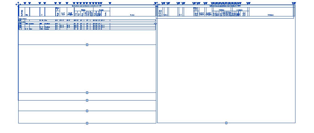

there are hidden colums but I have a duplicate schedule with inverse filtering that is fine... i managed to fix it by duplicating the good one and redoing the formating but I would like to know why this happened..
Wed, Mar 14, 2012 at 1:21:59 PM | Weird Schedule BUG
paulykustomz
paulykustomz Avatar
Joined: Mon, Nov 24, 2008
68 Posts
5 Stars: 1 Votes
here you go

Corrupted file.
