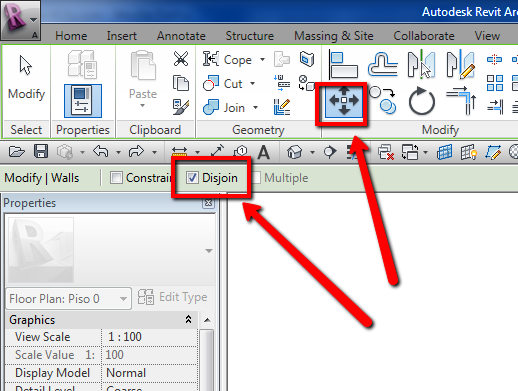

IM STILL A NOVICE SO EXCUSE MY IGNORANCE BUT IS THERE A WAY TO MOVE A WALL INDIVIDUALLY WITOUT THE ADJACENT WALLS MOVING WITH IT?  i HAVE A WALL I NEED TO MOVE JUST A FEW INCHES BUT WHEN I DO THE WALLS NEXT TO IT MOVE AND I WANT THEM TO STAY IN PLACE. ANY HELP WOULD BE APPRECIATED

Click on the wall, click "Move" then click "Disjoin".
