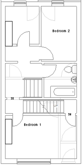

hi i am doing a drawing and faint lines of the walls and other components that i have drawn on the ground floor are showing very faintly in the second floor is there a way to get rid of this and i have attached a picture below.

In that view change the "Underlay" to "None"

THANX very much
