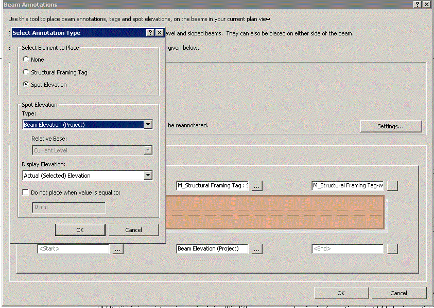

OK, can anyone tell me how to make a tag that would read:
 W14X22 (114'-6")
in which the 114'-6" is the "live" elevation (it changes according to the actual beam elevation.)
I don't want an offset value.  I want an actual value.  If the finished floor el is at 100'-0", the beam is at 114'-6", not 14'-6".
Using the "start level offset" parameter in the elevation label only works if I create a level at negative 100'-0". But then I have to place my beams at negatiev 100, and then I have to go back and offset them 114'-6", which is too stupid.
It seems that Revit thinks that everyone only needs an offset value instead of an actual value.
I want to place my beams at whatever reference level I am at and have the tag give the ACTUAL ELEVATION of the beam, not the offset from the level I am at.
I have played with the family parameter thing forever.  I think I need a new parameter that just adds a hundred feet onto the offset value, but I can't seem to get the formula syntax down or even apply that parameter to my label.

Why don't you just set yor elevation to project rather than relative?

Fri, Mar 9, 2012 at 12:03:19 PM | elevation tag
Like attached

I don't have a spot elevation thingy loaded for beams, only for walls.  CryingSee image) How would I load one?

So it's picking the lesser of 2 evils:
Either go with the beam tag and have the parenthesis but an offset value instead of actual  --(14'-6")
OR
Go with the spot elevation and no parenthesis, but the elevation can be set to be correct  --114'-6"
And there's no way to get into that spot elevation and use its parameters in a beam tag?
And you have to go to a fine detail view to do spot elevations on a beam and then switch back to coarse?
Sheesh....
Fri, Mar 9, 2012 at 12:47:44 PM | elevation tag
All spot elevation tags can be modified to use project elevation.
