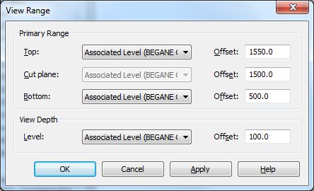

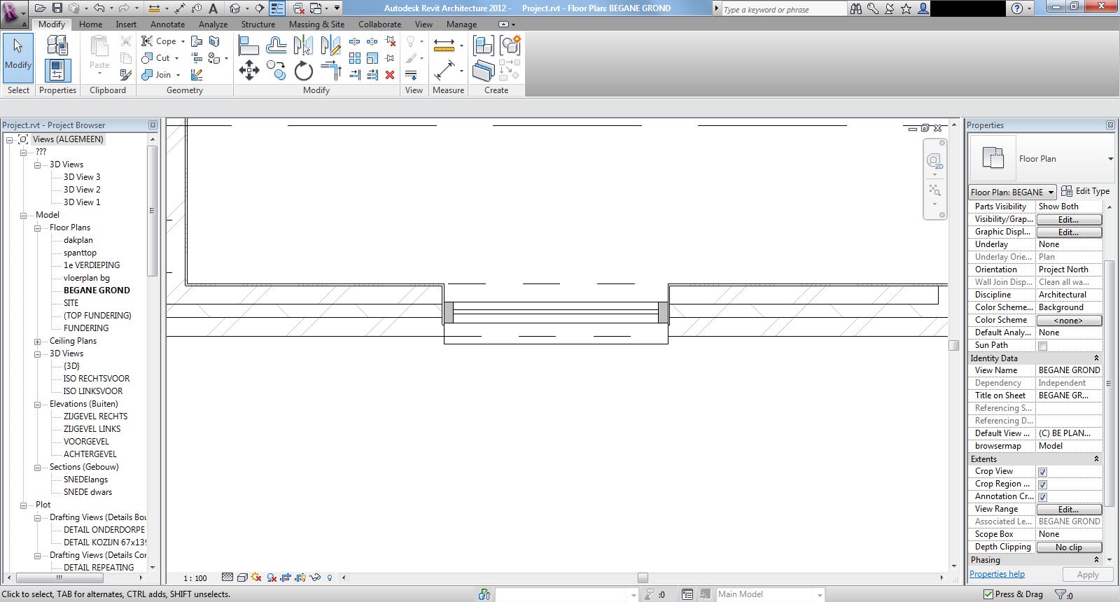

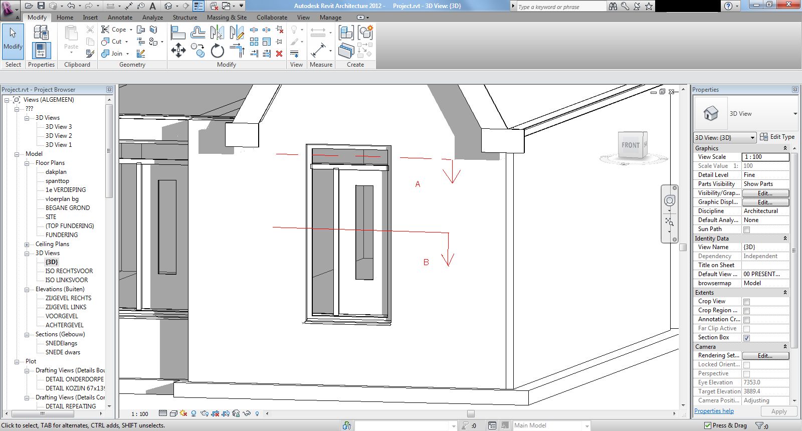

I made a window family from a door with an upper light. In the floorplan I would like to see the horizontal section at about 1500mm plus floor. According to my view range. For some reason I can only see the horizontal section of the window his upper light. Does anyone has an answer how to get the correct section visible in the floor plan. See my attached images.

In your family, set your plan view range at that cut level.
AND reload the family.

I tryed deleting and replacing the family with adjusted view range settings but the effect is just the same. The difference in view settings in the former window was only 50 mm above the cut plane in the project file or floor plan.

The problem is probably the visibility of your components in the window area of this family.  Change it from visible in plan to visible when cut in plan.

Thanks for your answers. I didn't fix it yet but I know now that it has something to do with the profiles. They look allright in the family drawing but they are flipping in the project file. (And dissapear in the walls) I quess I will have to delete and reload them in the project file. Strange because the problem didn't occur in a standard window family.

I tried uploading a dozen times whithout succes but here is a link to a small project file (revit 2012) with two similar families with light above the door and whithout it.

Select your window frame between top en bottom part and go to visibility settings,
uncheck plan/rcp
do the same for the top glass part.

Wauw ! It worked. Thank you very much.
