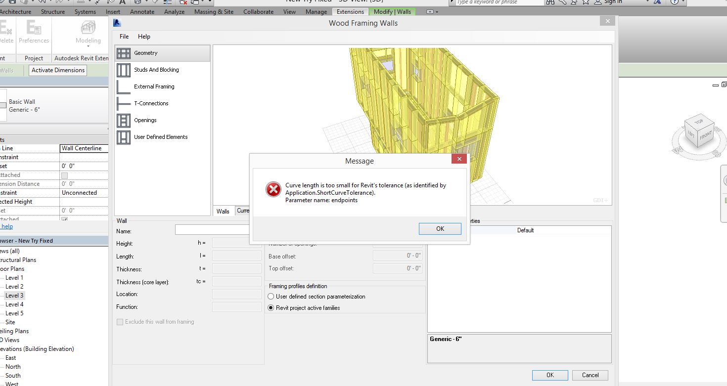

Mon, Feb 23, 2015 at 9:15:56 PM | Help with Frame generator extension
dinho2014
Joined: Tue, Nov 11, 2014
0 Posts
I still have the same problem now in February 2015. see picture attached. I have Revit 2014 - template Architecture, units:  Inches
How to fix this?? any ideas?
thank you in advance.
Edited on: Mon, Feb 23, 2015 at 9:17:03 PM
Tue, Feb 24, 2015 at 8:09:16 AM | Help with Frame generator
This is not a units issue - it is your geometry.  You need to take a better look at how you describe it.
