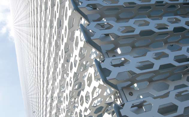

Hi,
what would be the best way to model this kind of facade, without (or mimize) slowing down the model?
I was thinking to model it as a component, model in place wall but then i think it's going to take a huge size of my RAM, or am i wrong?
all suggestions are welcome.
best regards
Steven
Wed, Mar 7, 2012 at 8:15:45 AM | facade modeling
What is the scale of those elements?
In order to improve performance.  If you model them, put them on a workset that is NOT visible in all views and use reduced workset loads.  Only turn them on when you really need them.
