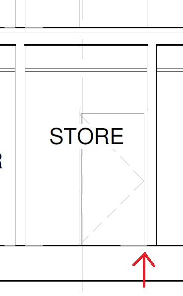

I have been having an problem with my projected element lines in my sections. As the problem only appears once I open the print preview and not within the model, I think it may be a print setting issue but I could be wrong.
I have attached a jpeg showing an example.
The elevation of the door has overidden to a half tone but even though it is a projection it appears to take presidence to wall which has been cut. I have tried different methods to achieve this effect (instead of using halftone, simply changing the line colour etc) but all have been unsuccessful.
Any help would be great. Ultimately I need my cut elements to stand out more from my projected elements, giving my sections better clarity.
I realise that changing line weights could also achieve better deliniation but I don't particularly want to change this project wide.
Thanks in advance.
Tue, Mar 6, 2012 at 6:54:05 AM | Problematic Projection Lines In Section
Lineweights can be set by view if you don't want to change project wide.  And these can be controlled by view templates.

I usually draw over with detail lines.
