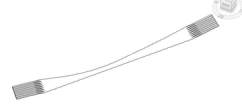

I'm trying to create a curved monolithic stair, and it't ok in 2d, but it won't generate in 3d.
Is there someting I can change, somekind of thickness or other parameter?

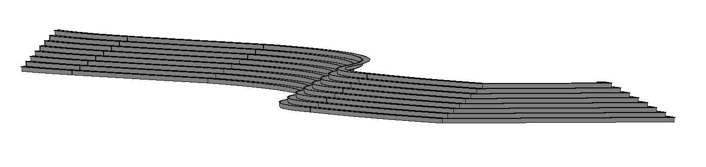

There is a bunch of weird stuff happening on this.  I might try to create a new stair and import in the default monolithic stair to override this one so you can start fresh.  When I opened it, basically nothing showed in 3D.  I noticed the riser thickness was set at 0 as was the tread thickness.  If they have no thickness, they won't show.  The attached image is what it looks like after I change the thickness to a number greater than 0.
