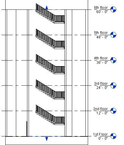

This is my first ime using revit and I can't draw these stairs! I put on proprties start level 1st and connect to 6 level but as you see in atttachment it draws below the level and it is not connected to the wall. Please direct me to fix it and I appreciate it.

Without seeing the actual file its hard to tell whats going on.  But Revit does not automatically draw top or bottom landings
, only intermediate ones.  You would have to draw your own top/bottom landing.  Typically in a building your top/bottom
landing is the floor slab so there is no need to have it created by the stair tool.  Hope this helps, if not, try posting your file.

Is your view a section or elevation ?
Show us a 3D view and a section that shows the entire stair.
Do not make the stair go from the 1st Floor to the 6th floor. The stair should go from the 1st Floor to the 2nd Floor.
** Then select the stair and in the properties turn on 'Multi-Story' and set the top to 6th Floor. As long as the Floor to Floor heights are the same it will work out.
