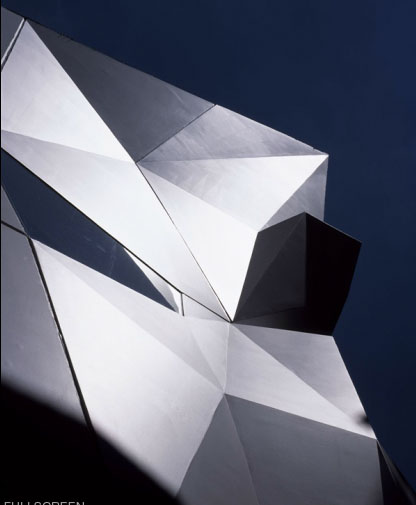

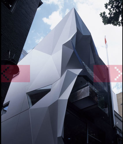

I have to complete a project using REVIT. I was just wondering whether anyone could tell me or instruct me on how to model walls that look like this?. I have tried curtain wall pattern but that just makes the whole wall the same. Thank You.

conceptual massing tools will do this, then apply wall by face

Thank you for the quick reply. So would I do this in a new project or would i create a new conceptual mass first?Sorry I am new to this kind of modeling. Maybe you could explain in more detail? Or link some websites Puh

you can build it in a project as a massing but i prefer to use the conceptual massing enviroment. theres plenty of videos on youtube I'm sure.
