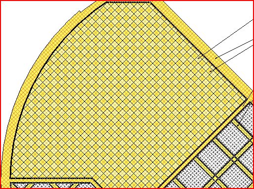

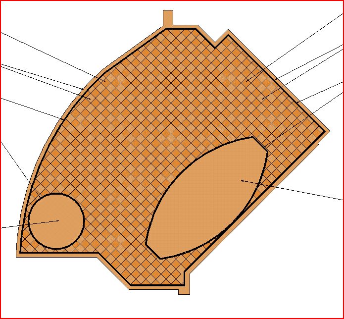

I have attached images to illustrate my issue.  I have created new floor types and have assigned a material and color to them.  The darker floor is accurate.  The lighter one is not. The floors are identical in height, type and I can't seem to find any differnece in the veiws other than the lighter one references a section.  But I'm not sure if that would be a factor.  I checked the section for any issues, just to be sure, there were none.  Please help me fix this weird issue.

Make sure all your view properties are the same.  (Visual style)

I found that I can alter the color in the Graphic Display Options if I take the light one to 0 sun and 0 ambiant light it darkens.  Then if I increase I can try to get a close match by taking the same setting way up on the dark one to lighten it up.  But I still don't understand why they wouldn't appear the same at the same settings, being that they are the same floor.
