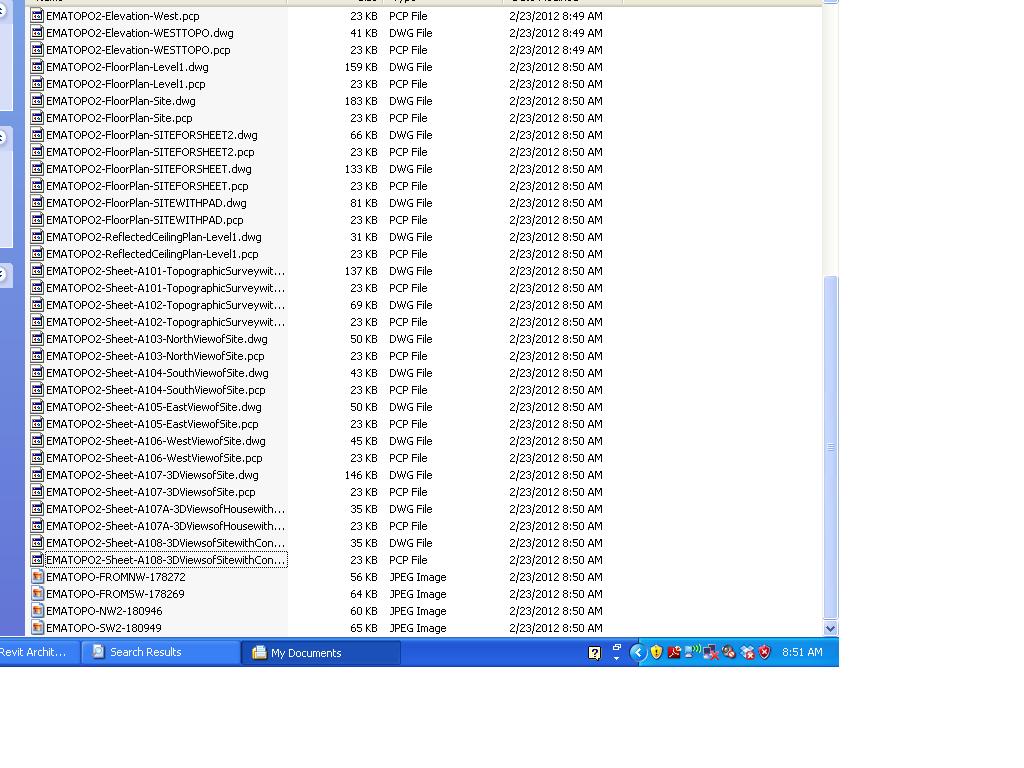

Hey - yeah checked all the times/dates etc.....I've attached a screen shot (But they often don't attach so might not show)...I've fiddled round but keeps seeming to create a heap of different files....not sure what else to do : (
Wed, Feb 22, 2012 at 2:28:53 PM | EXPORT TO DWG - Problems
I think you may have not cleared your selection set and you have views as well as sheets selected for export.
Do one sheet into a clean directory and verify that you have done it correctly.  If that doesn't give you just 2 files - dwg & pcp & you jpeg's then you may have a corrupt program.
