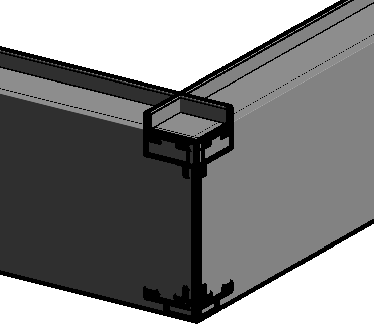

Making progress.  I was able to insert the family like I needed with "Place on Workplane" and as a chain.  Now my next issue is at the corner intersects.  When I try and join the families, it says "Can't cut joined element."  If I try and unjoin and then repeat the command, it says the same thing.
Fri, Feb 17, 2012 at 12:03:15 PM | Custom Beam Help
#14
mbsteve
mbsteve Avatar
Joined: Fri, Sep 22, 2006
759 Posts
4 Stars: 13 Votes
Think you are heading in the correct direction, try the miter tool. or stop one short, how do you do it in practice, do you have a special part that fits that corner?
