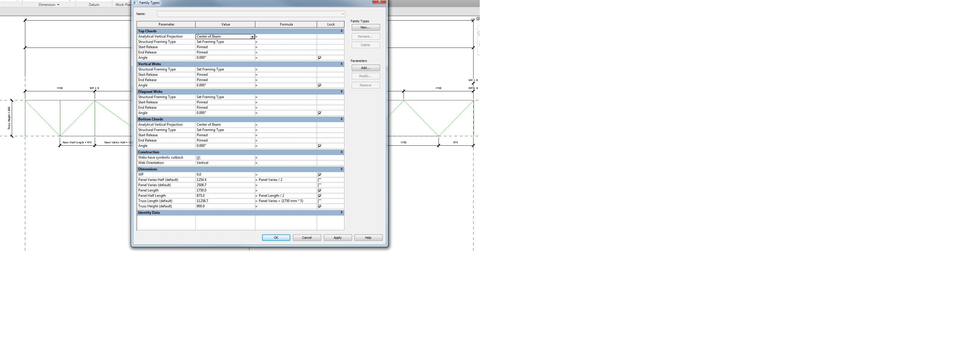

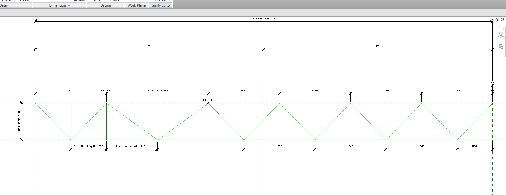

Dear all,
i have modeled a 2d truss using the metric structural truss template. however in my truss their are two different diagonal web sizes.
however i only seem to be able to too have one size for all. i want to use real steel sizes not extrusions as i want to be able to take a steel take off on the model.
is it possible to have two different diagonal web types within the family types dialog box.
kind regards
Thu, Mar 8, 2012 at 11:26:51 AM | TRUSS FAMILY diagonal webs
teafoe5
teafoe5 Avatar
Joined: Fri, Nov 12, 2010
1749 Posts
4 Stars: 47 Votes
As far as I have seen in a line based truss family you can only have one type of web.
