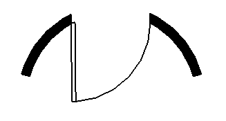

yeah that's what i do, but say for example on a curved wall, the opening cut will create an opening perpendicular to the wall where as a void cut will only work as you create it, in most cases, stay as a rectangular cut perpendicular to the window rather than the wall. if that makes sense.

Wed, Feb 8, 2012 at 10:11:52 AM | Opening cut and Void cut not allowed
Sorry but you are wrong, the opening cut works just like your void would.  See attached simple wall with standard door.

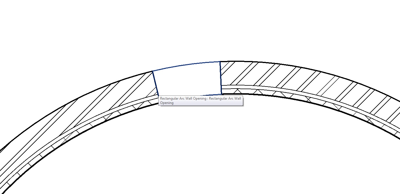

Thu, Feb 9, 2012 at 2:22:06 AM | Opening cut and Void cut not allowed
JRPcad
Joined: Thu, Jul 1, 2010
136 Posts
See attached Hub
This is what I meant, wall opening creating a perpendicular cut to the curve. This was a standard wall opening, i suppose i could create a sweep with a bit of good maths that followed the radius of the curve not sure how i'd go abot it but i'm sure i'll figure it out Winking
For Architectural Services visit www.jrpcad.co.uk
Thu, Feb 9, 2012 at 7:19:16 AM | Opening cut and Void cut not allowed
You are right.  A wall opening does cutthe wall perpindicular to the faces.  But you were initially talking about an opening cut in a family, which is something completely different than a wall opening.  You can not place an "opening" in a family.  That is a project system tool.
