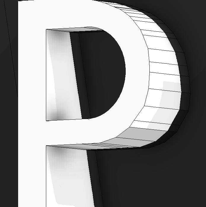

The attached image is an enlarged portion of signage from a perspective view. The letter "P" shown in the image has a bunch of lines from how the arc was drawn. The signage in question is a logo that cant change much, so short of changing the way that the extrusion is sketched, is there a way to hide the lines in a perspective view? Thanks in advance

"is there a way to hide the lines in a perspective view?" - LINEWOORK tool > Invisible Lines
