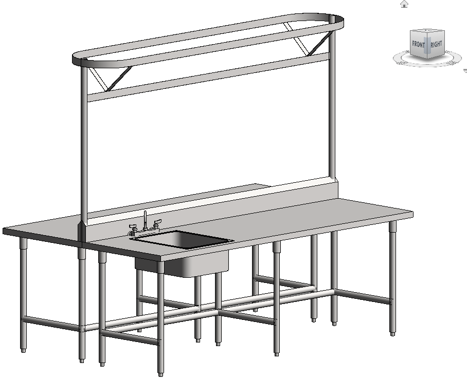

Is there a good way to set a 3D view to a specific viewing angle other than what you can get by clicking the view cube? I'm trying to set up some iso views of some equipment, and so far I'm having to click one of the corners of the view cube, then eyeball it into the position I want.

You're probably right, I'm a little rusty on my terminology. What I would like is in the attached pic, whatever it is called.

And axionmetric views have no real definition except that like isometrics, the dimensions (excluding angles) are still all true.  Cabinet views would have depths foreshorted by half.
Since there is no way to set your angle in Revit, here is a suggestion.
  1. Create a 2D view that has the angles you want and place it on a sheet.
  2. Place a model cube 3D view over this on the sheet and adjust is as best you can visually.
  3. Name that 3D view and lock it (I think you can in 12)
  4. In any 3D view, use the oriet to view and pick this cube....
Didn't try this but I think it will work.  Might even be able to put this cube in your template in a special category or workset that is always hidden.

That worked great. The only thing I did differently was place the detail lines right on the sheet instead of in a seperate view. Thanks.
