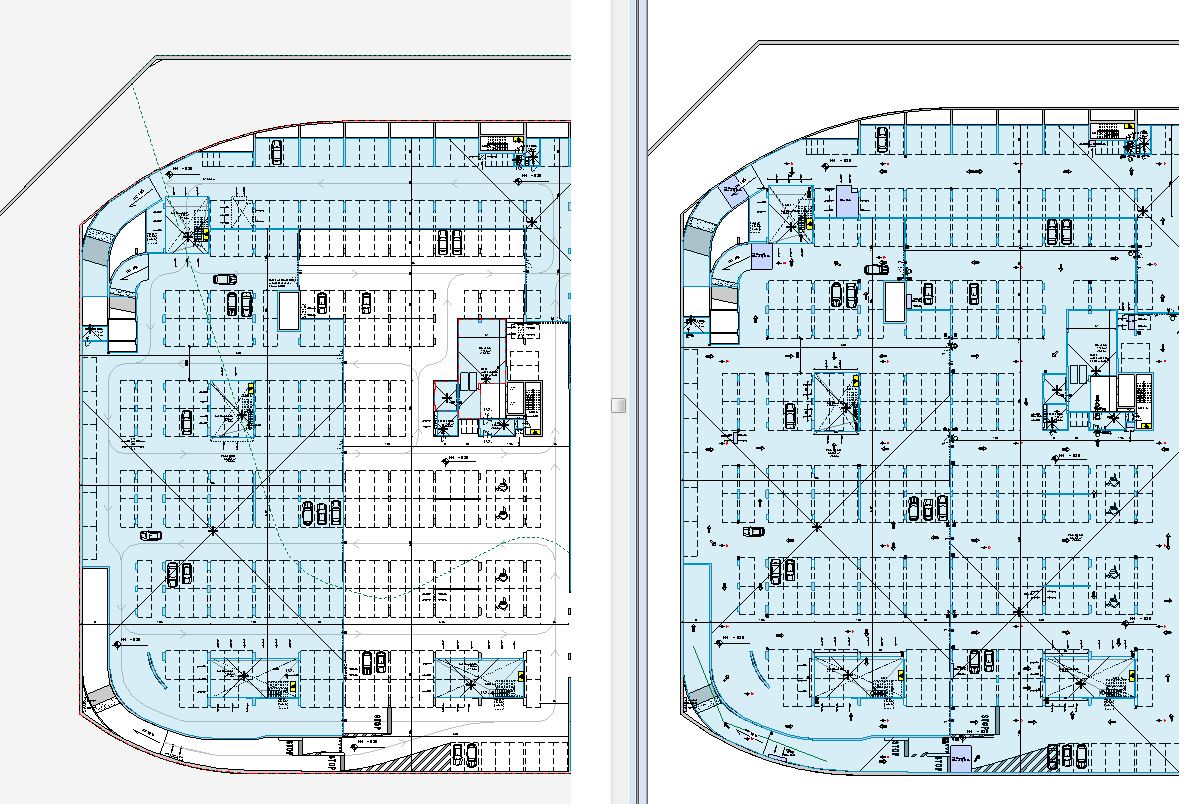

Hi,
I'm using Revit 2011. I've a issue with a room. The room exists and is shown in all views but in the one I need. Therefore I can not even place a tag for it.
All other rooms are seen in every view.
The view properties are the same for each view and the room properties as well.
I checked worksets, hidden objects, separation lines, visibility filters, and everything seems alright.
I attach the view of two different rooms of the same level, one showing and on not showing the room.
Did anyone have the same problem?Thanks!
Mon, Feb 6, 2012 at 7:52:36 AM | Room not showing
There are too many possibilities for what is wrong here.
The easiest solution is to create a new view and see if you can tag it there.  If so, you can copy, paste same place, all 2D elements to this new view and delete the old.
