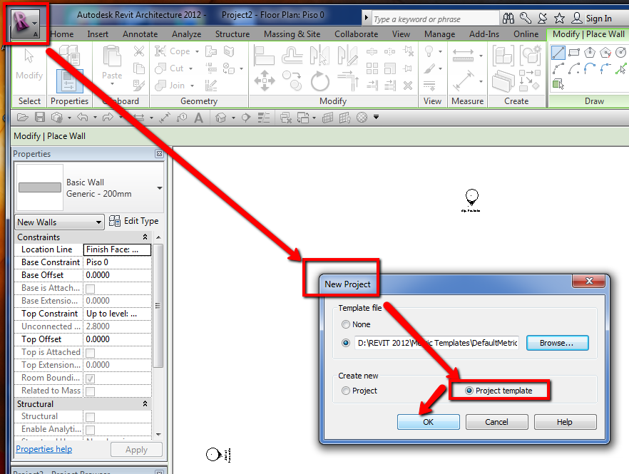

Start a new project File > New project then select Project Template and change the storefront wall parameters like you want, now save as template.
