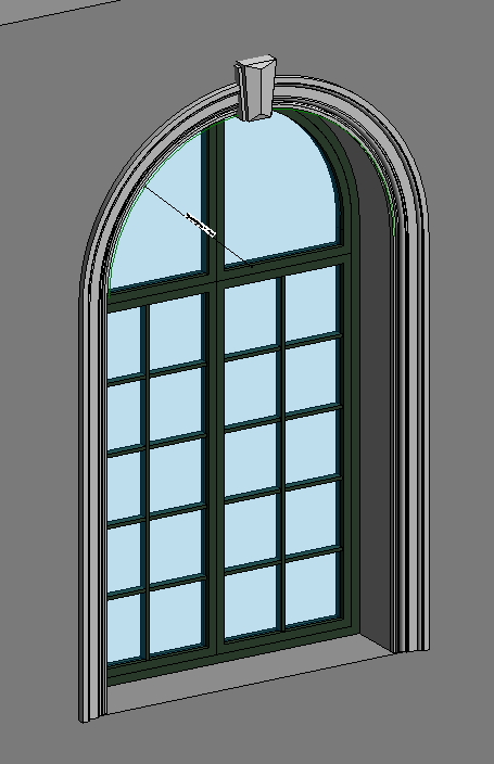

It's queit easy to make a family with half oval beacause oval provide two dimensions.
But if you want to use arc, it's not that simple.
Try this when you need a arched window family that can be changed head height but rectagle height.
I used the Pythagorean theorem for it.
attached images will help you to understand.(it's Korean ver. but that won't be a problem.)
