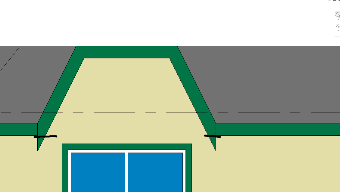

I want to trim the green trim on this existing drawing Im working on.
check out this image. how can I get the trim to not be that sharp bottom edge? I can't think of the solution to this.
Thanks in advance

Have you tried joining the geometry?  It looks like they are two different size trims.
Wed, Feb 1, 2012 at 9:33:07 AM | trimming trim corner.
If you apply your roof facia to both roofs in the same operation, then they will miter correctly.

That worked great.!! thanks Hub!
I had a very small bit of roof projecting forward out, that needed a piece of facia to connect the two.
