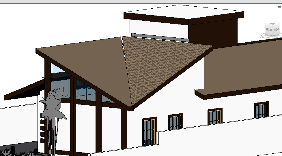

Hello everyone,
Any hints on how can I make these two roof panels as one piece. It is difficult to manage the two roofs fit the same spot bottom and up.
Thanks

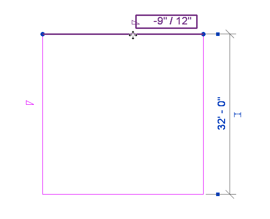

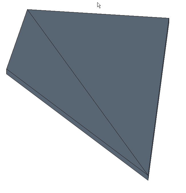

Tue, Jan 31, 2012 at 8:08:00 AM | Roofing question
Like this?
You can't really break Revit so try things!  This is just a negative slope from the flat ridge.
Tue, Jan 31, 2012 at 10:39:26 AM | Roofing question
Maycon
Joined: Thu, Mar 4, 2010
14 Posts
5 Stars: 2 Votes
as simple as that! thank you so much! saved me time and a headache.
