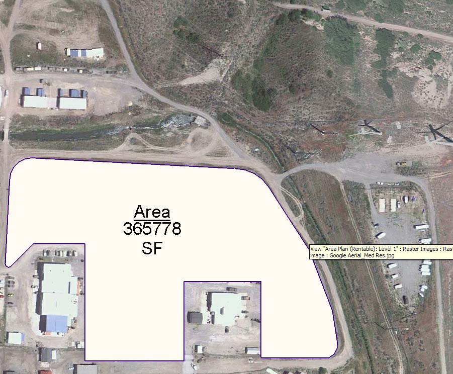

i know but i made an area plan to image so there is no walls or plan and the color schemes is solid i cant see through it the image is that possible on revit ?

there is a pic to explain what i mean

Oh I see.  I don't think there is a way to just have it shaded but I am not positive on that.  You could try using a different fill pattern such as diagonal lines so that it would show through.
Fri, Jan 27, 2012 at 12:06:27 PM | area color schemes
Don't use an area plan.  Simply a transparent fill with text.

i tried to made cross up with big pattren but it not shown through .. thank you

Quoting WWHub from 2012-01-27 12:06:27
sorry i just saw your comment ,so you mean fill region ?
