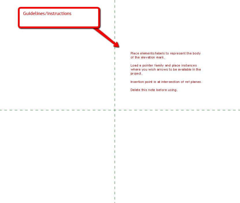

Available internally means for your office use. But since its for commercial use, either you give an instruction on how to use options in your family with a text instruction that the end-user can delete later or make the text invisible when load in a project (see sample family). With the guidelines/instruction the User will be acquainted with what your family can do before he/she loads it to his project.

Here's the attached.

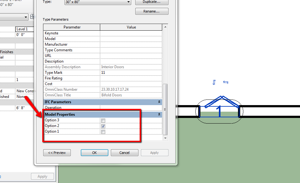

I think I see where your problem is. You're on the right track, you're just missing linking the two parameters. You'll need two integer parameters (I'll call them Param1 and Param2).
Param1 is what the user interacts with.
Param2 is what actually controls the yes/no parameters. This is also where your greater than/less than formula will be used. The trick is, in the formula tell it to look at Param1 instead of Param2.
So, this goes in the formula for Param2 'if(Param1 < 1, 1, if(Param1 > 3, 3, Param1))'

I set up the Yes/No parameter for the three options, I could only get switch between two Yes/No parameters. The idea is to check one box and the others uncheck. When I introduced a third option the third check had to be switched off manually. This is why I set up an integer parameter to select one of the three options by clicking 1, 2 or 3. Do you know a way to set up the Yes/No parameter so when clicking "Option 1" the other two options switch off?
Hi Tkennedy, thanks for your reply. My original posting tried adding that formula to a second integer parameter, please see my original posting. Unfortunately my images aren't uploading so you didn't get to see the screen shot. It dosen't work for me, the second integer with the formula changes alright as I change the options, when I click 0 or 4 the formula works and constrains the numbers as expected to 1 or 3. The problem is the Yes/No check boxes clear so none are checked at all then.
I would expect the numbers 1,2 or 3 would be checked but they all clear as soon as 0 or 4 is input. The formula driven integer remains at 3 when number options increase to 4 or above and remains at 0 if the number options decrease to 0 or below.

See attached images.
User Control is the parameter the user will interact with. Parameter Control is what the Y/N parameters read, and is tied to User Control.

I got hung up on using two integer parameters like you were trying, so it didn't occure to me that you can easily do it with just one. Basically, split up your greater than/less than formula, and put it in the formulas for the Y/N parameters. See the attached image.

Thanks TKennedy,
I have tried the process you suggested several times but when I input 0 or 4 in the User Parameter, the Yes/No check boxes completely clear so none are checked. If I input 1, 2 or 3 they check accordingly. I know the formula works because I can see the numbers updating in the Formula value field, i.e. if I input 4 the formula defaults to 3 or if I input 0 the formula defaults to 1. The problem I have is not with the formula but that it dosen't connect to the check boxesSmile
However, I tried it out in a blank family template and it worked fine so now I know the process works but I still have the problem in the family I'm working on.
