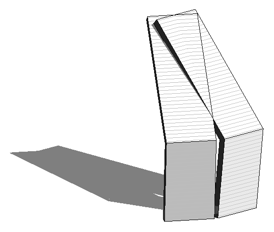

Cannot get walls to connect vertically with each other!http://content.screencast.com/users/zuzullo/folders/Jing/media/71026a49-d300-4699-a014-7939d27b82c0/2012-01-20_1528.png
Please see the video of the issue here: http://screencast.com/t/emiU9Wn1p3J9

Or, let me know if you know another way of tilting walls!

...all sort of crazy design happens in Revit but when One wants to tilt and intersect 2 walls, it becomes an impossible task! Smile
ANYONE PLEASE?

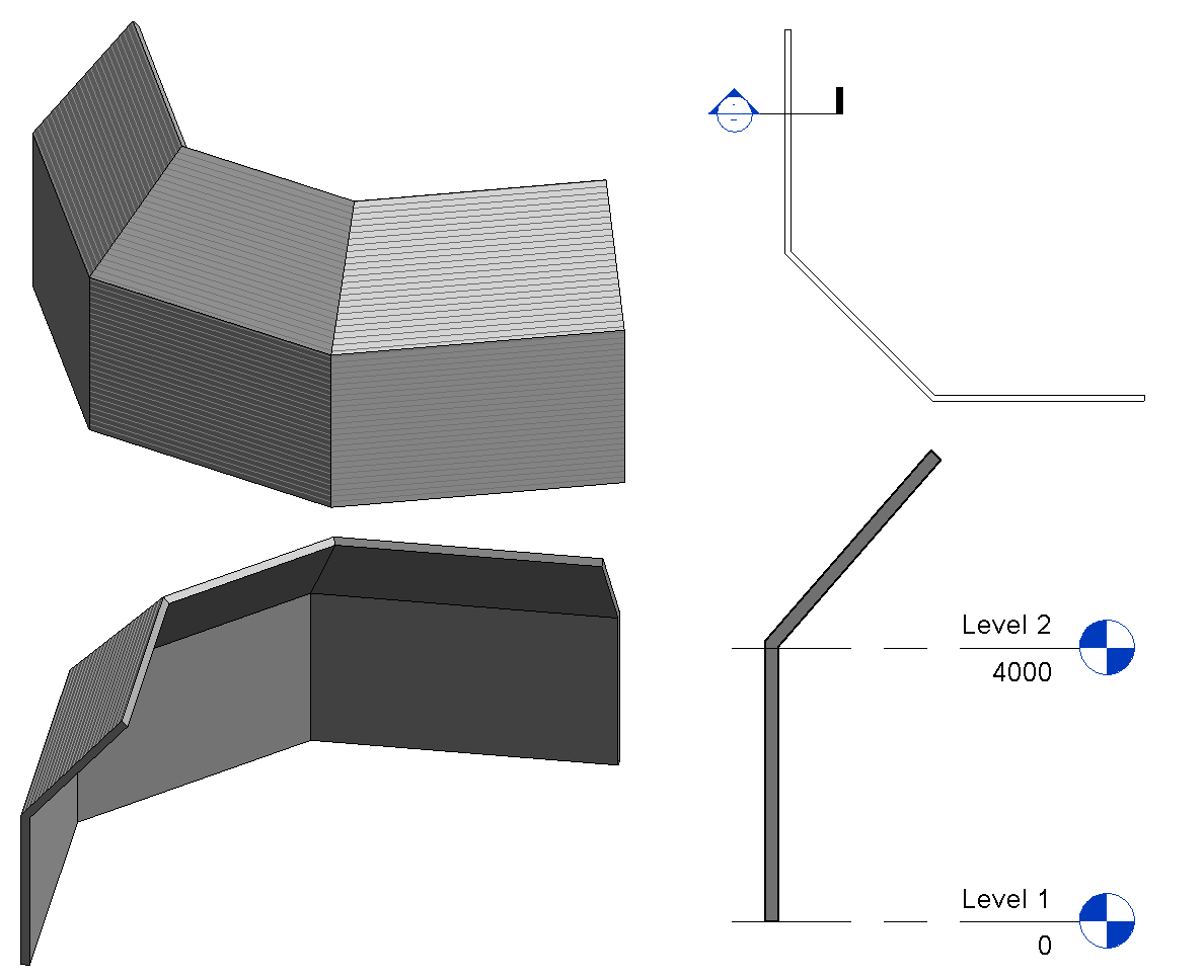

Ok this may help as well:
http://content.screencast.com/users/zuzullo/folders/Jing/media/535f0fd4-23d8-4ff9-b5f2-71a1b07a09ed/2012-01-23_1417.png

Can you create the walls as an in-place mass?

Yes, in-place model using sweep.

I was able to create the walls shown in the attached image with an In-Place Component (family) and a 'Sweep'.
While still in the editor I also 'Painted' the wall surfaces with a 'Siding' 'material.
Is this what you are trying to achieve ?
* Don't forget to make the In-Place Family 'Category' 'Wall' so it will adhere to the visibility settings etc. . .
