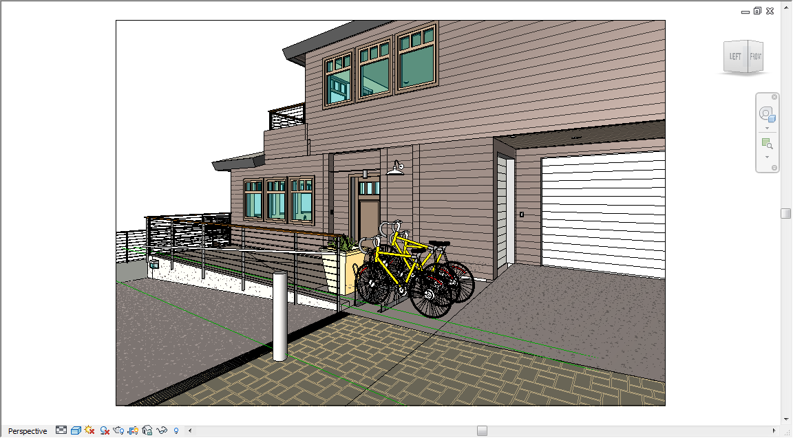

this flooring pattern, is simple 3D pattern

Tue, Jan 17, 2012 at 6:45:44 PM | detail lines on sloped floors
#13
mbsteve
mbsteve Avatar
Joined: Fri, Sep 22, 2006
759 Posts
4 Stars: 13 Votes
WW,
This is sloped and warped.
