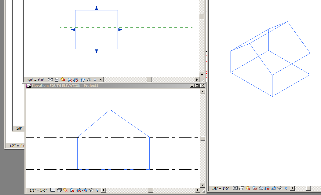

hello every body ,
i have to make gable mass in place family how can i do it , when i tried to made it its be flat not gable can you help me please ?

Mon, Jan 16, 2012 at 11:06:01 AM | gable mass in place model
Like this?

  1. Create a reference plane in your plan view to work from.
  2. Switch do your elevation and turn on mass.
  3. Using the reference plane sketch the form - mass category.
  4. Set the extruded form depth.

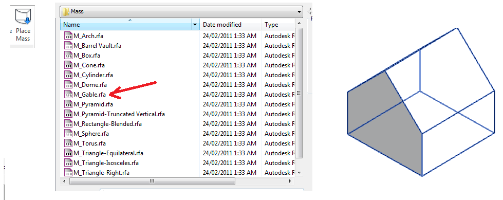

If I understand this correctly, what about loading one of the predefined Mass Element Families that comes with REVIT ?
There is a gable family ready to go.
See Image.

yes i already used this one for some  building but others its has compecated edges so i cant use it beacause the edgs are not the same
