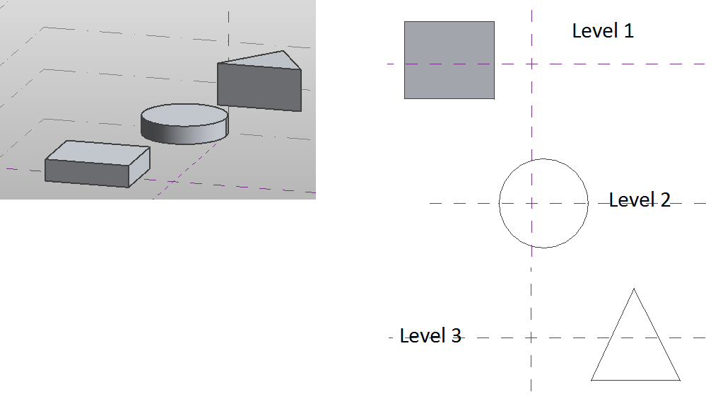

I've got a conceptual mass issue here.  I have a large conceptual mass (a huge tangle of piping, walls, and ductwork) and I would like to print out various levels of it.  But all the levels show everything, as if my view range is unlimited and I see the floor, ceiling, 2nd, and 3rd levels all at once.  HELP!

Are you on the top floor or site plan looking down on a wireframe view? Or you have not come up with levels? Or you have overlays? Or can you show a screenshot so we would know that is going on?

I was able to replicate your problem.
The fix was two fold.
a) Adjust 'View range' Top and Cutplane. (maybe check the bottom and depth as well.)
b) Remove the default 'Underlay' that the Conceptual Mass Template applies to each level plan view.
Also use hidden or shaded view. Not Wireframe.
See attached Image
