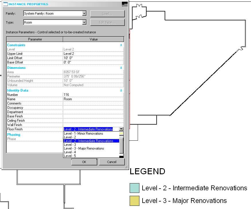

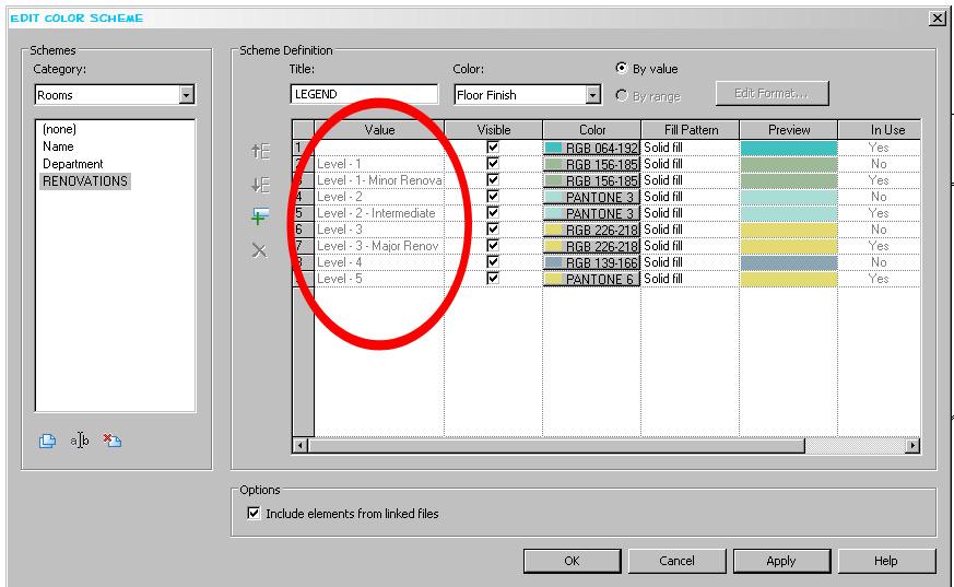

no, you still aren't understanding. see the image I attached?  I entered a VALUE that said "Level 1" and created a color scheme, then selected each room that I wanted to be at "Level 1".  But now I want it to be "Level 1 Minor Renovations".  So I want to just edit (UNDER THE VALUE column) "Level 1".  But instead, I need to create a new value and call it "Level 1 Minor Renovations" and then go back to my plan and re-select each room and change it to the new value.
Does anyone else out there understand or have run into a similar problem?  is there no easy way around it?

ok, here it is.
Suppose I had misspelled "minor renovations".  It shows up in my legend.  What if I want to change that?  I CANNOT.  I have to go into the "edit scheme" and create a new VALUE parameter with the correct word, then go and select the room on my plan that needs to be changed and select the new parameter from the element properties.  I don't want to do that, I simply want to be able to click on the parameter within the edit windo and change it.

#9
As I posted earlier "That value is the value you placed in the room parameter called "RENOVATIONS" .   Change it there. "  Click on the room in the floor plan and edit the room properties!

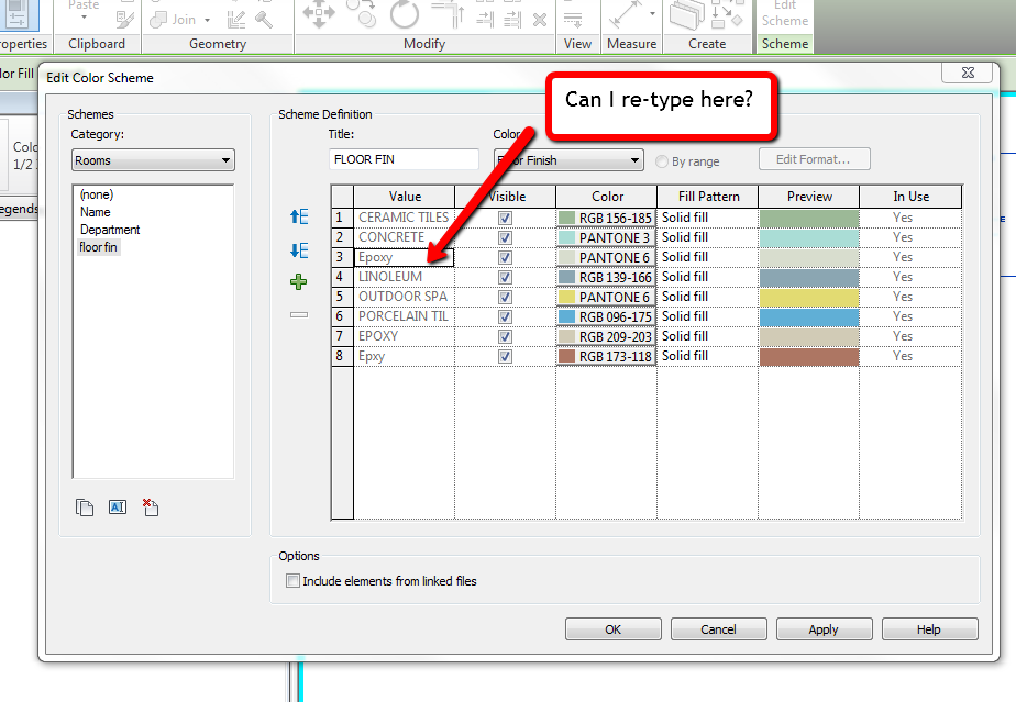

Wed, Aug 15, 2012 at 5:43:23 PM | Color Scheme Edits
#10
mhans
Joined: Tue, Nov 7, 2006
456 Posts
3 Stars: 10 Votes
Same dilemma using Revit 2013. I wanted to rename the word "Epoxy" to "EPOXY". I already assigned Epoxy to a lot of rooms and I don't want to go back and redo them. Is there a better way?
