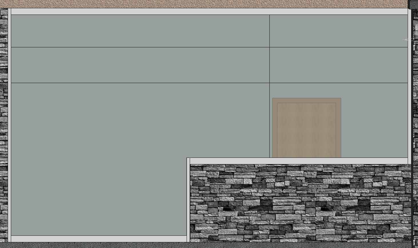

See attached image.
I am trying to make an L-shaped curtain wall where a portion of the bottom frame is on the floor slab and a portion is on a 4' high watertable. I tried making the full rectangular curtain wall and deleting the bottom right mullions and panels, but the wall cut remains intact and there is a gaping hole in my building. I also built the wall by face to the shape I wanted, but the mullions I need at the watertable height and vertically at the corner of the watertable keep bringing error messages. It will not let me place a segment of a grid line at those crucial points to continue my mullions. Is there another way to do this?
Thanks for the help.
Wed, Jan 11, 2012 at 10:17:21 AM | L-shaped curtain wall
Just edit the (curtain) wall sketch like you do a regular wall in elevation.

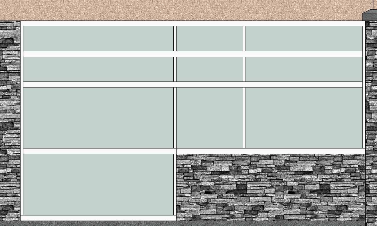

I could get the shape to work in the wall. It's the mullions that would not cooperate.
Solved: I was able to create mullions that offset to one side of the grid line so they line up with the appropriate frame.
