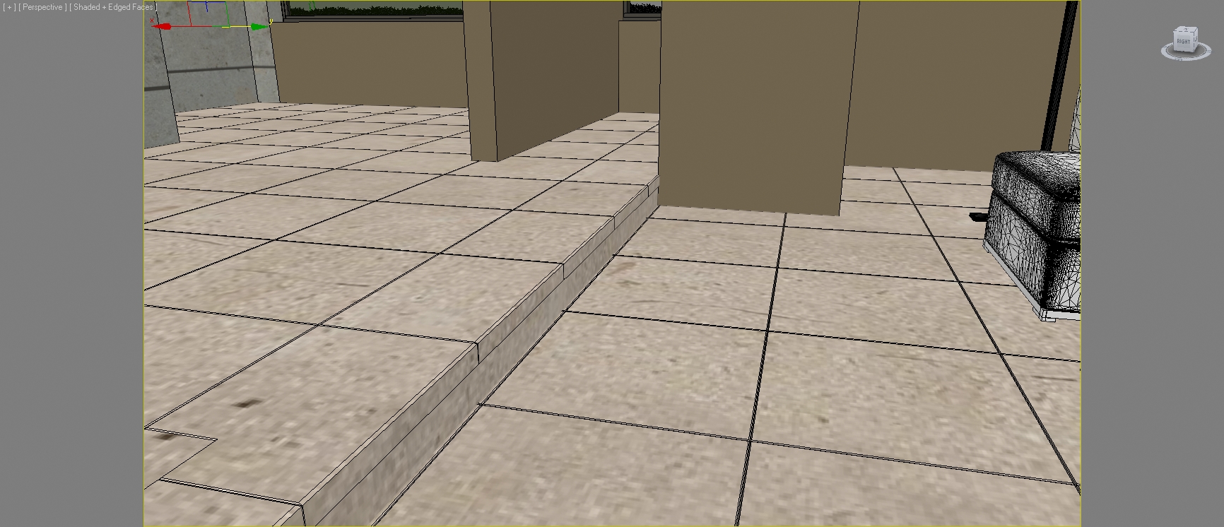

Hi everybody!, I want to create 2 tiled floors at different levesl, as shown in the picture. Do I need to create another level for this lower floor, or should I separate the 2  floors. I'd appreciate if someone could suggest a workflow for this, in such way that revit can "understand" for generating accurate sections and schedules.
thanks in advance

This is really your option.
If you make it all one level, I would choose the lower as my base with the raised floor defined as such.  This allows all rooms / walls / other items to be defined as being on the same level.  Just remember to raise the doors and other level hosted elements in the raised area.

if you want it to schedule as one level. then i would follow WWHub advise.
