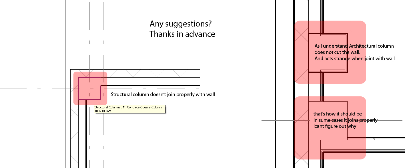

Hello everybody,
This is my first thread in this forum so please don't be very critical about it Smile
The case is that my structural colums dont act like it should, well in some cases it does. I attached the explanatory image.
Does enybody encountered problems like this? Have I missed any threads about this?
Thank you in advance

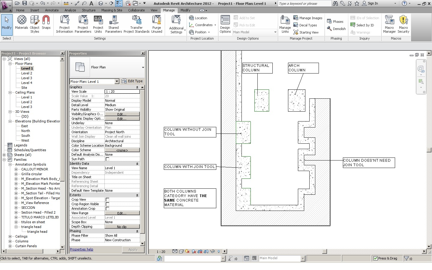

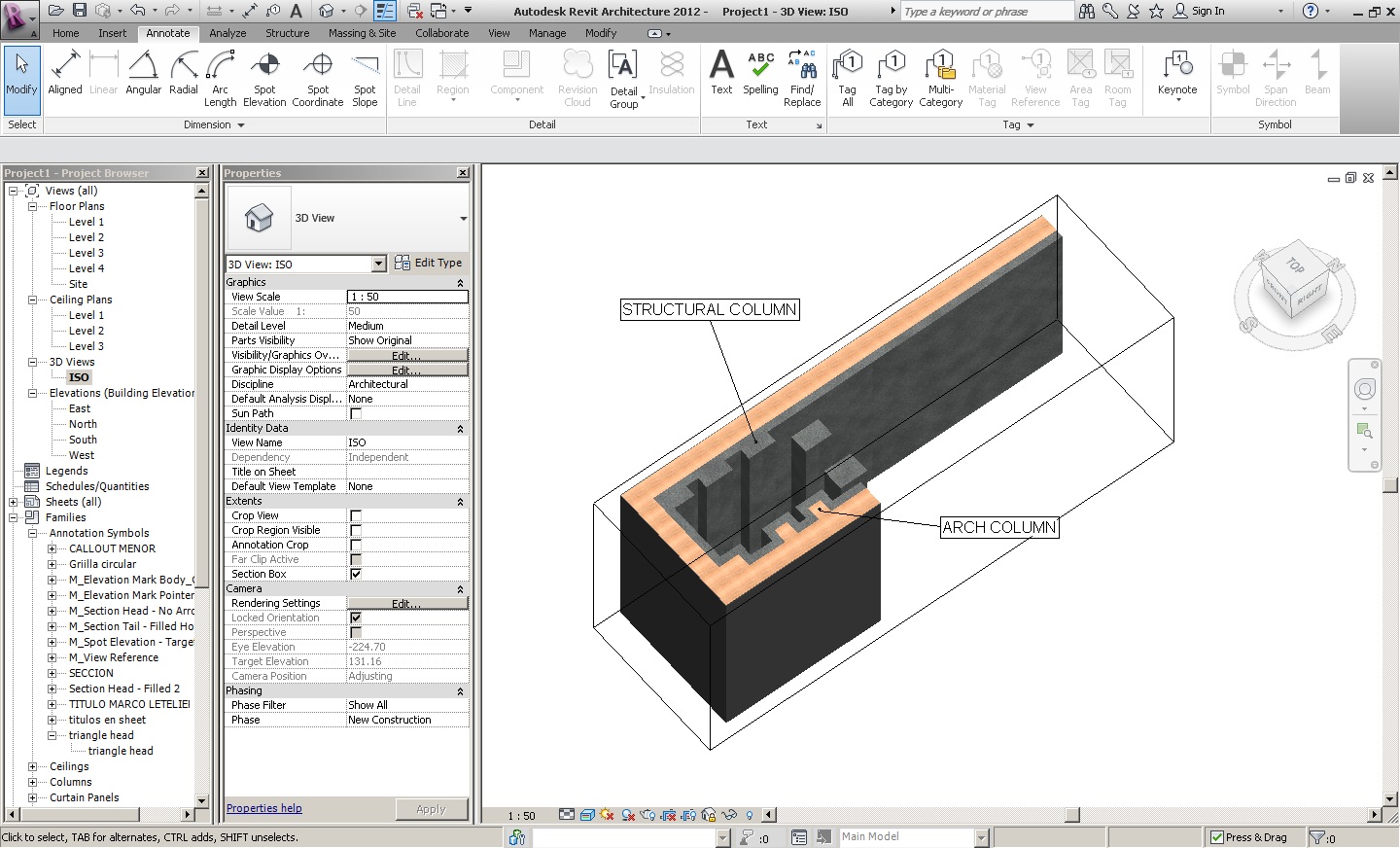

The problem is that you have to set the correct category, and then join the column when its needed.
Here you have an example file

I do understand the issue with differences between structural and architectural columns, but when i join walls and structural column, somehow column and 2 layers of plasterboards and thermal insulation merges into one. pic 1
