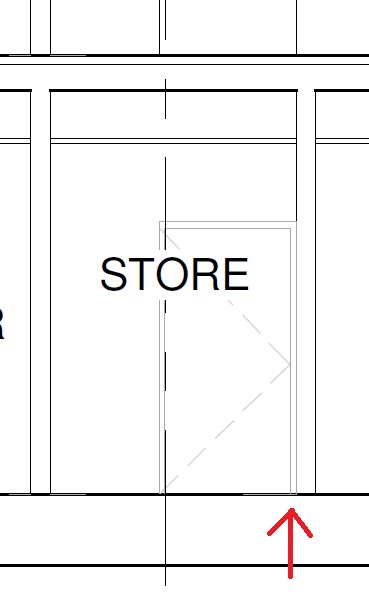

I have been having this exact same problem. As the problem only appears once I open the print preview and not within the model, I think it may be a print setting issue but I could be wrong.
I have attached a jpeg showing an example.
The elevation of the door has overidden to a half tone but even though it is a projection it appears to take presidence to wall which has been cut. I have tried different methods to achieve this effect (instead of using halftone, simply changing the line colour etc) but all have been unsuccessful.
Any help would be great. Ultimately I need my cut elements to stand out more from my projected elements, giving my sections better clarity.
Thanks in advance.
P
Tue, Mar 6, 2012 at 6:57:56 AM | Toggle cut and projection lines
It took awhile for me to understand your question.  You are talking about the right side of the door which shares a line location with the adjacent wall.  This is a problem in Revit when you have two lines in the same place.  I suggest you use your linework tool on the door line.
