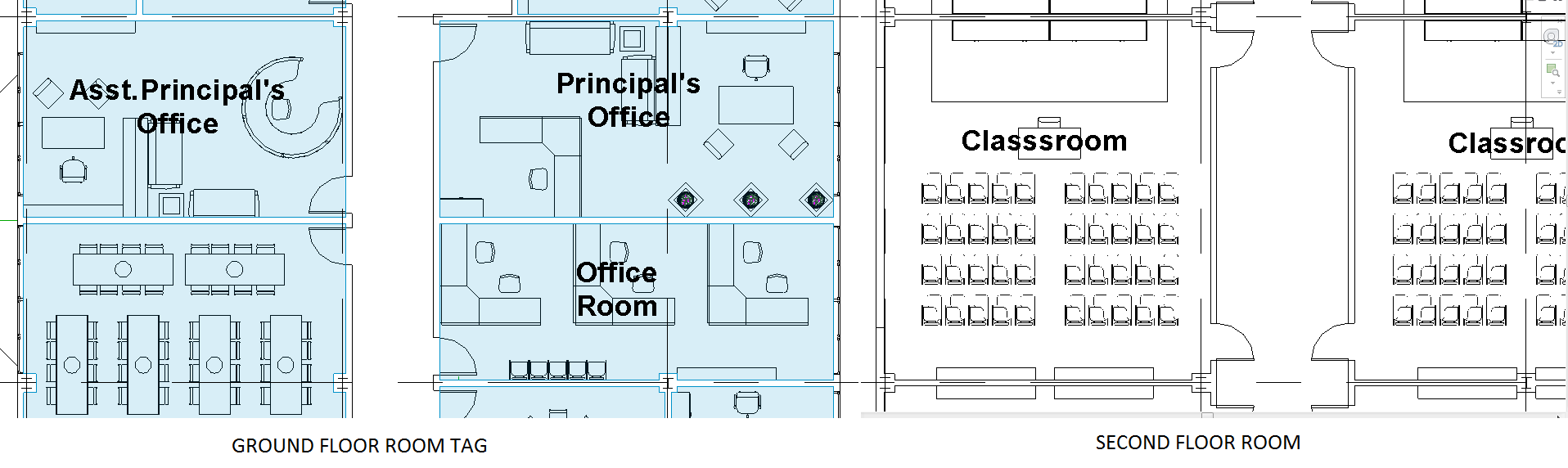

It's simply a room tag but the i can't do what i please. the problem is that on my project when i placed the room tag on the ground floor rooms all rooms have this "blue highlight" but when i placed the room tag on the second floor all rooms have no "blue highlight". How do i get rid the "blue highlight"? THANKS :3
Thu, Jan 12, 2012 at 7:55:53 PM | Room Tag Dilemma
raja15
Joined: Mon, Feb 21, 2011
84 Posts
5 Stars: 1 Votes
Maybe the Room Colour Fill is turned on.
Try this:Open up your ground floor view and type VG (Visability Graphics Shortcut).
A window should appear showing everything by category which is either turned on or off.
Simply scroll down to [+] Room and expand the list.
If Colour Fill has a tick þ in it, simply un-tick it and click OK.
This should hopefully turn off that blue shading for you.
